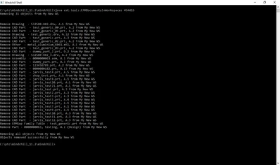

I'm looking for a way to clear the contents of a Workspace and the cache automatically, without user intervention.
Long story:
We've got a server that's running a Creo 7.0.x.0 installation for conversion from prt/asm to stp.
We can't use a worker for this as we've got a third party software involved.
The Creo session is started using a batch-file, so adding an "rmdir \..\..\.cache2008" command is trivial for clearing the cache as we see fit, if we don't want to use the dm_cache_limit setting (which we don't).
However, the Workspace is still just adding more and more new items as it's downloading, and around some GB or 20k files, it's slowed down the task a lot. Manually logging onto the server is a way to do it, but not ideal.

Zoli, hi
Maybe you could describe the big picture?
For example how do you know it’s time to generate a stp file and run it through the third party tool?
Are you working off a list of numbers thus a bulk stp creation?
Are you doing this when the objects state is set to whatever?
Maybe you can supply details on your process?
That said, how do you know which WS to remove from?
I wrote a utility that will remove all objects from workspace given the WS. It works great but if you don't want any user interaction there needs to be some logic to determine which WS to remove the objects from.
The utility can be triggered anyway that's required. Below I ran it in a Windchill shell.
David

d_graham18-OpalAnswer
18-Opal
Aug 5, 2021 3:13 PM UTC
Zoli, hi
David
