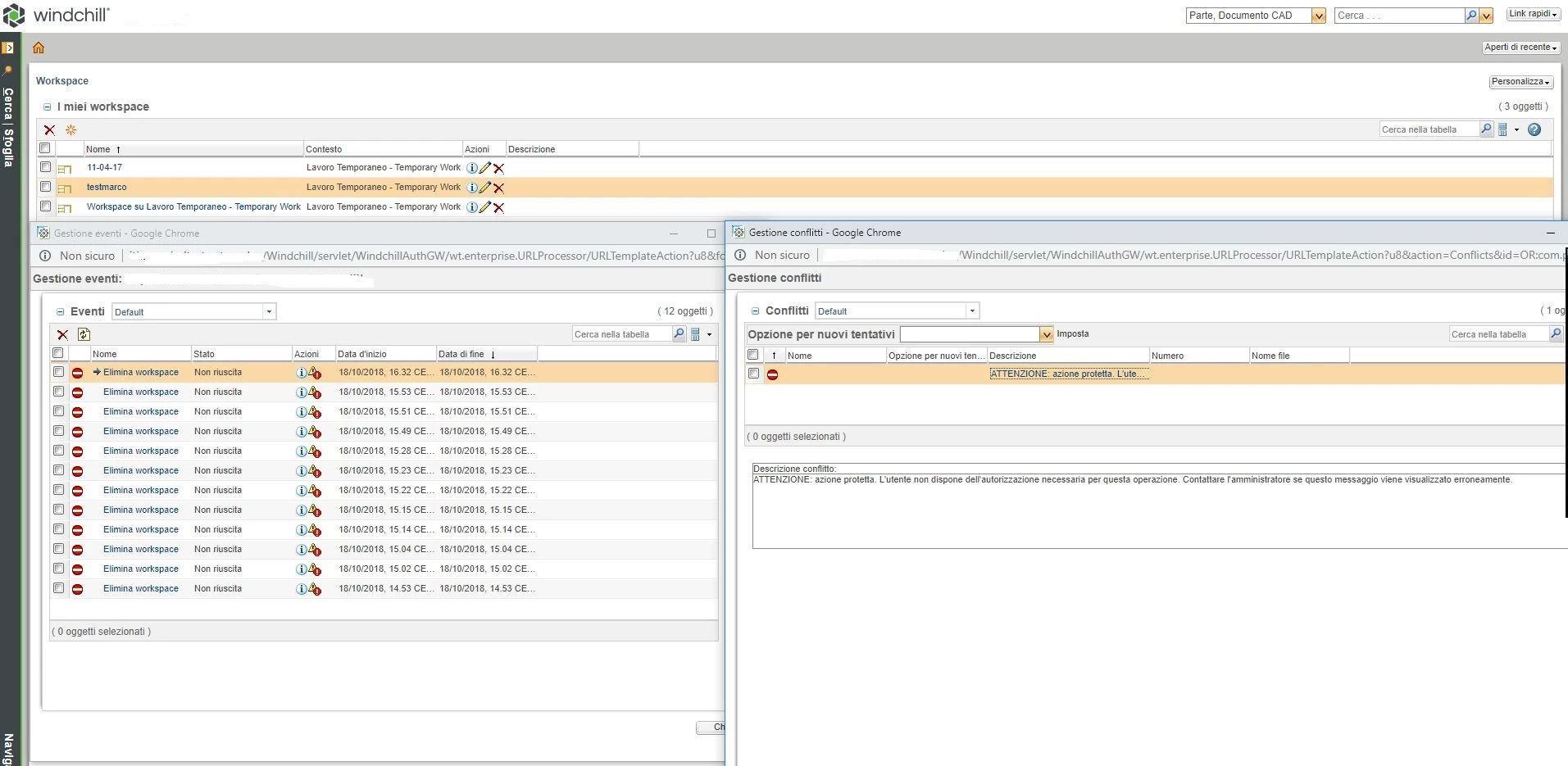

In our windchill 11 installation, the users can only create a workspace, but don't can delete.
In photo the error.

But this permission already existing in windchill.
If I acces with site admin, I can delete workspace of others user.
How I can fix this problem?

I found the problem.
A policy on WTObject that prevented deletion.
