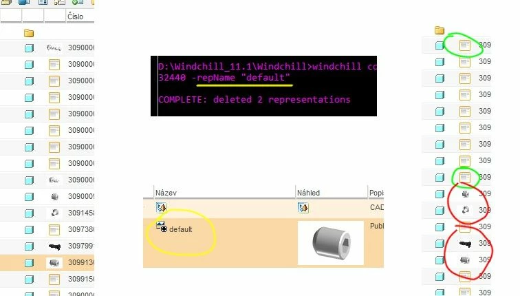

I have run DeleteRepUtil command to sweep all repres on specific product but seems to work kinda partially.
Even there are other CADs with "default" repre it has not been deleted everywhere. Any ideas why?
Left column is before (6 repres to sweep) and right column is after delete. Expected all deleted but 4 remained...even repre name is similar.
Other questions is if it possible to republish only data on specific product? Can run WVS scheduler but for whole Org/Site which is not necessary.
Thx

Not sure why your representation have not been deleted.
However, it is definitively doable to launch a republish job at a product level.
Just browse to the utilities page of your needed product, you'll find the "WVS Job Scheduler".
