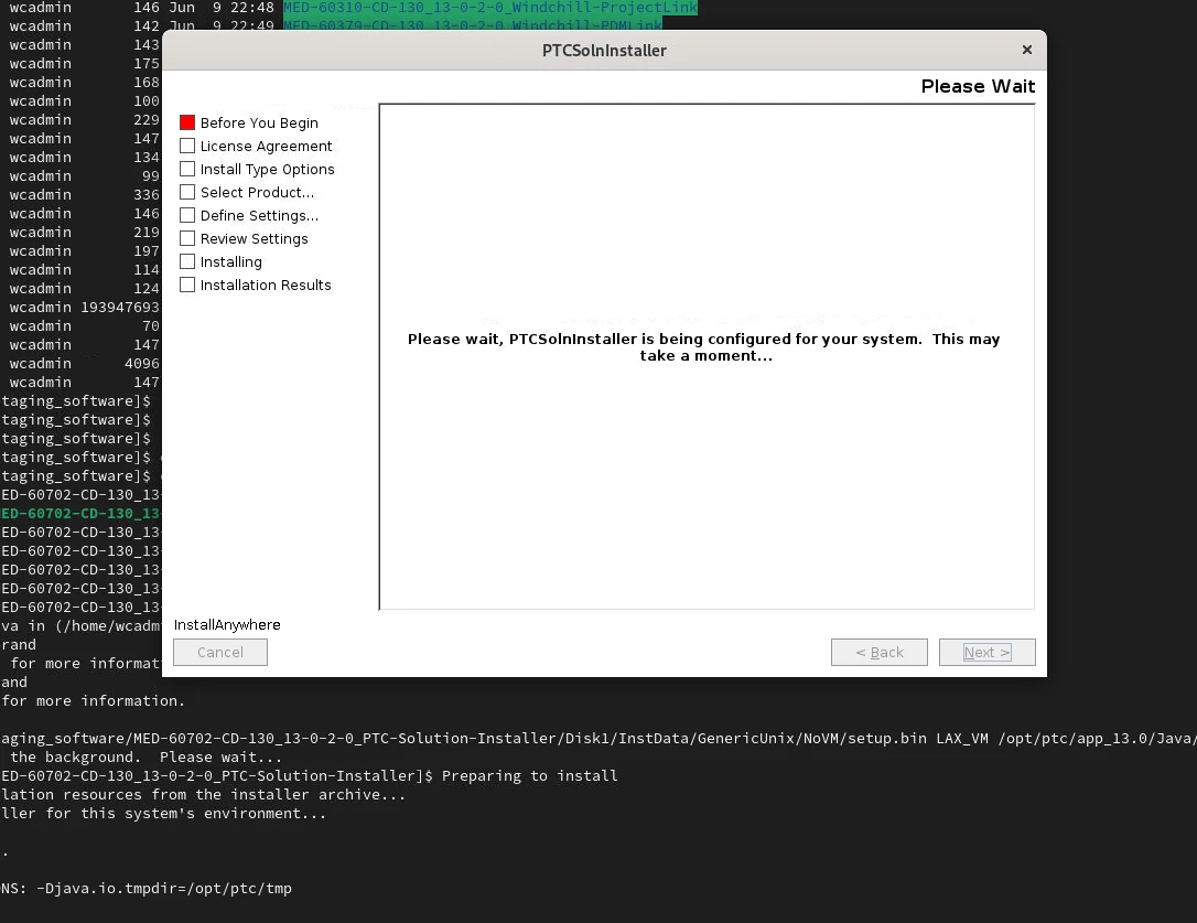

Did anyone tried installing Windchill 13.0.2.x on RHEL9.2 ?
Version: Windchill 13.0
Use Case: When Launching PSI installer, the Next button is faded.
Description:
RHEL 9.2
Windchill Version 13.0.2.5
Java : 17.0.11 or 17.0.15
When we launch the PSI installer, The Next button is faded and i dont see any loggers captured under /tmp.
JimwangAnswer
Jul 4, 2025 12:29 AM UTC
The problem is due to the file /etc/issue is empty.
Next Steps:
1> Rename the /etc/issue file, e.g: mv /etc/issue /etc/issue_backup0704
2>Re-run the test tool: java -cp . PlatformTypeTest
3>If you can run the test tool successfully without exception and get something like below, then you should be able to run PSI:
       **** PT getcurrentOS: Linux
       **** PT getVersion: REDHAT9
       ******It is not Centos8 *****
 Please let me know the result.

Yes but I installed 13.0.2.4 if that matters but I am using RHEL 9.2. I assume you've retried and it stops at the same spot? There should be some logs. Checking my notes, I did not use the default temp folder (/tmp). I mapped it to another folder with larger space:

6-Contributor
Jun 27, 2025 7:53 AM UTC
/tmp has 14GB free space.
I even tried mapping it to different directory /opt/ptc/tmp, here as well the same issue.
export _JAVA_OPTIONS="-Djava.io.tmpdir=<new tmp location>"
