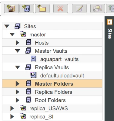

we are doing windchill rehosting of our dev environment (Windows based). we have filled all the required data in the rehost.properties file but we are stuck at vault section.
what does those '0' and '1' means in the attached snap vault_properties.png?
we have master vault and a replica as shown in below snap
Windchill version 12.0.2.7

Vaults rehosting is per vault mount.  Each number defines a different mount location.
Say your production system points to network locations like this:
0) defaultuploadrootfolder: \\\{production vault server}\D$\PTC\Vaults\defaultuploadrootfolder
1) defaultsystemrootfolder: \\\{production vault server}\D$\PTC\Vaults\defaultsystemrootfolder
2) defaultsystemrootfolder2: \\\{production vault server}\E$\PTC\Vaults\defaultsystemrootfolder2
And development looks the same (except with different mount paths).
0) defaultuploadrootfolder: \\\{development vault server}\M$\PTC\Vaults\defaultuploadrootfolder
1) defaultsystemrootfolder: \\\{development vault server}\M$\PTC\Vaults\defaultsystemrootfolder
2) defaultsystemrootfolder2: \\\{development vault server}\N$\PTC\Vaults\defaultsystemrootfolder2
Assuming you already cloned the file vaults from production to development locations, your rehost script snippet will look like this.
### FileVault Settings ###
target.fv.required=true
source.fv.path.0=\\\{production vault server}\D$\PTC\Vaults\defaultuploadrootfolder
staging.fv.path.0=\\\{development vault server}\M$\PTC\Vaults\defaultuploadrootfolder
target.fv.path.0=\\\{development vault server}\M$\PTC\Vaults\defaultuploadrootfolder
source.fv.path.1=\\\{production vault server}\D$\PTC\Vaults\defaultsystemrootfolder
staging.fv.path.1=\\\{development vault server}\M$\PTC\Vaults\defaultsystemrootfolder
target.fv.path.1=\\\{development vault server}\M$\PTC\Vaults\defaultsystemrootfolder
source.fv.path.2=\\\{production vault server}\E$\PTC\Vaults\defaultsystemrootfolder2
staging.fv.path.2=\\\{development vault server}\N$\PTC\Vaults\defaultsystemrootfolder2
target.fv.path.2=\\\{development vault server}\N$\PTC\Vaults\defaultsystemrootfolder2
### Vault Host Settings ###
source.fv.hostname.0=windchill.acme.com
target.fv.hostname.0=windchill-dev.acme.com
If the file vaults are on the local server and in the same paths, then just make all three values match.  Or try excluding them entirely and just populating the Vault Host Settings.

sandy0078-GravelAuthor
8-Gravel
Aug 29, 2025 1:53 PM UTC
Hi @mmeadows-3 thank you for brief explanation.
I have few more questions.
1. the vault is configured on the same server where application is installed. so the path you have mentioned in the 2nd scenario will be applicable right?  and also the vault folder should be copied from prod to dev server ?
2. what are the efficient ways to copy the vault drive (80GBs) from production to development windchill servers (both are hosted on different VMs). Eg. below both the drives are for vaulting for production.
Thanks.
Aug 30, 2025 1:11 PM UTC
1. Yes.
Per your images, it appears the system is using the default upload vault and it resides inside the Windchill load point.  The master vault has a read-only root folder mount on the E drive and a read-write root folder mount on the F drive?  The clearer picture would be the mount paths from Site > Utilities > Vault Configuration > Site > Master > Root Folders.
Provided drive letters and paths are not changing, you can just change the host names and not worry about path mappings.
