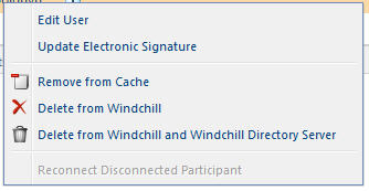

Darren,
Thanks for the quick response but as you can see in the picture below the Save As line is not present. I believe I'll contact my VAR to find out what's up as they do our installs.
Unless you know how I can turn on this function....
Mark

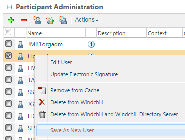

Oct 10, 2014 7:07 PM UTC
"Save As New User" was available in WC 10.1 as of M020. I do not have access to a WC 10.0 system. Did you check the WC help for any additional infomation within your WC 10.0 system? I don't remember this functionality being availalbe in WC 10.0 M030.
