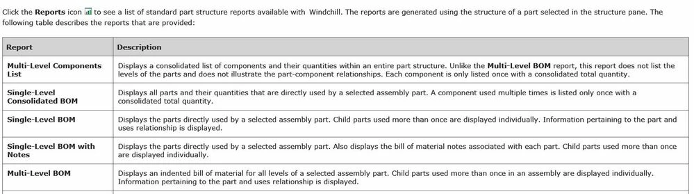

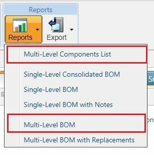

Difference between Multi-Level Component list and Multi-Level BoM List
I am new in windchilI and PLM Tools so I was wondering what the difference between Multi-Level Component List and Multi-Level BOM  is.

May 30, 2019 9:09 AM UTC
You can find your answer in the Help Center (see below image).
Marco
