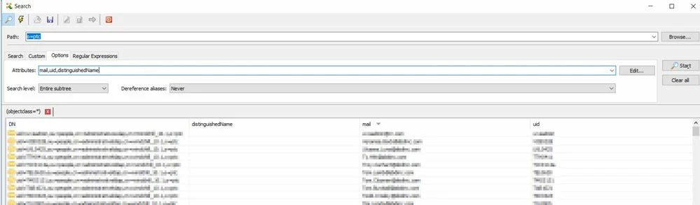

How can I pull a report out of the Windchill Directory Server that has the below fields on it?
DN (distinguished Name)
Mail (Email)
UID
Dec 13, 2018 7:20 PM UTC

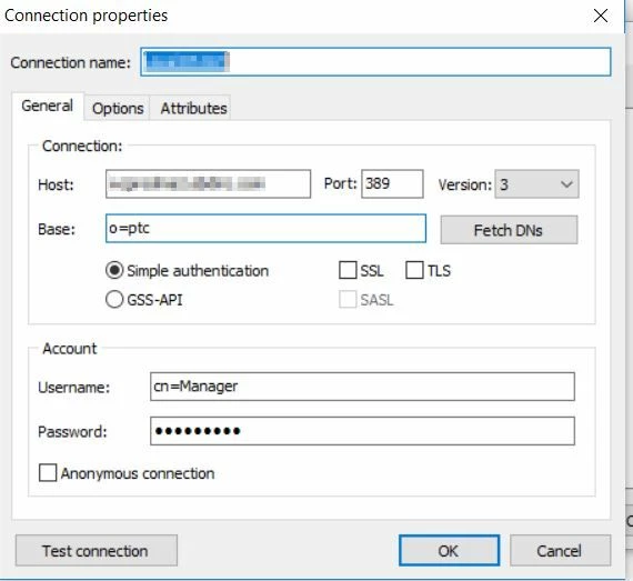

You can use the tool LDAP Admin to find this information: http://www.ldapadmin.org/
This tool has custom search and filter where you can add the attributes of your choice, search and then filter based on your requirement
