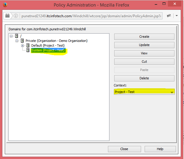

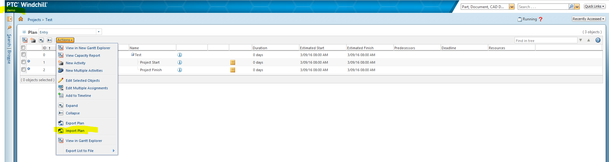

I have to disable the option of Import Plan for a particular role/user in a Project created by me.  I tried doing it using Policy Administration, but could not do it. Please let me know how to do.

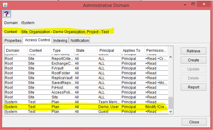

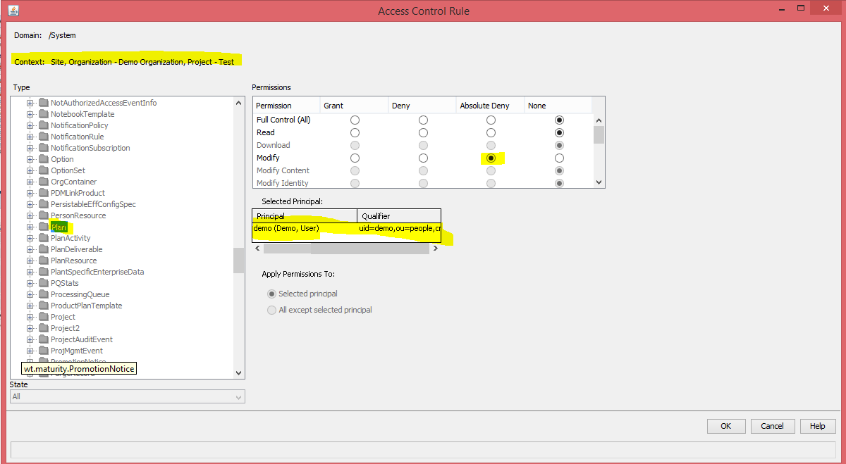

Prasad,
I took a look at the validator code used to determine if Import Plan should be enabled in the menu. It checks whether or not the user has Modify permission in the Project's /System domain on the Plan object. I created the following permission on my system and it disabled the action for that user:
You can use a regular Deny, rather than an Absolute Deny, on the Modify permisssion, too. I just used Absolute Deny for testing to make sure that it would definitely get applied.

Lori,
I tried using the solution you gave but still, i did not get the solution. Have look at these screenshots.P1.PNGP2.PNGP3.PNGP4.PNG
I tried Giving Deny/Absolutely Deny to Modify only but it did not worked, then i did same for all permissions except Read, doing this disabled all options which were disabled for you except Import Plan. Please check let me know if there is any mistake in what i did.
