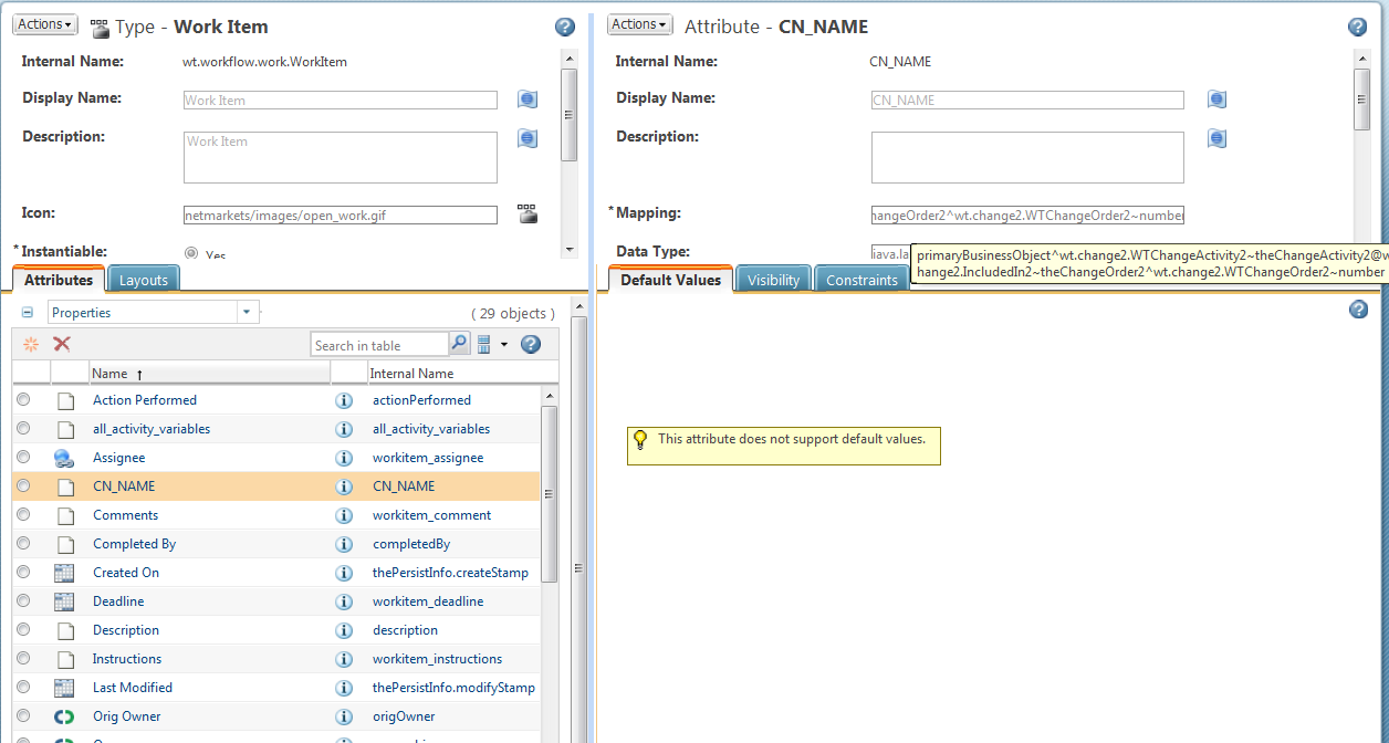

My users have a legitimate complaint in this one.  They are wanting to know, at a glance, from their Tasks list which Change Notice the Change Activity task generated from the Implementation plan was created in.
By default there is a Name (task name for the workflow node) and Subject (a concatenation of Type-Number and task name as defined in the implementation plan), however, there is no reference to which CN the Task was created from.
I am looking for any creative way to help the users determine from which CN there CA tasks are coming from across their assigned list.

Cameron,
Unfortunately alias attributes are not always straight forward.  In this case you need to start with the Change Task and then navigate to the Change Notice and get its info - the Alias attribute is:
primaryBusinessObject^wt.change2.WTChangeActivity2~theChangeActivity2@wt.change2.IncludedIn2~theChangeOrder2^wt.change2.WTChangeOrder2~number
The Work Item entry looks like the following - not I am mousing over the field to highlight its entry
And results in:

In 10.1 M040 and newer one can add Alias attributes to the workitem that can be displayed in the Task table.  For example one can show the CN related to the CT in the Task table.  See the following link for information:
http://support.ptc.com/cs/help/windchill_hc/wc102_hc/index.jspx?id=SiteAdminChp_BestPracticeDisplayAliasAttrOnMyTaskTable&action=show
Here is an example showing the CN as well as an attribute from the CN (you can navigate across relationships to get other attributes)

Jeff,
Awesome response!  However, I am having trouble showing the CN Number or Name for the Work Item generated from the task on the Implementation plan (CA workflow).
I've tried:
primaryBusinessObject^wt.change2.VersionableChangeItem~name
primaryBusinessObject^wt.change2.WTChangeOrder2~number
Neither of which do exactly what I want.
Please advise.

Cameron,
And results in:
