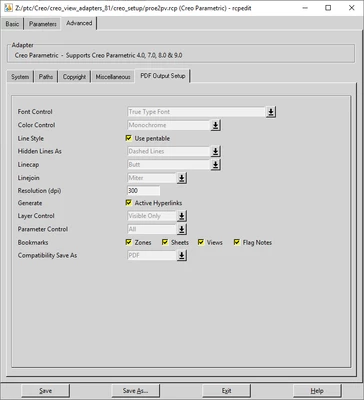

Do Catia Worker Recipe file has option to generate PDF Compatibility Save as PDF/A-1?
Creo worker recipe has option to generate PDF Compatibility Save as PDF/A-1.
Do the same option available in Catia worker recipe?

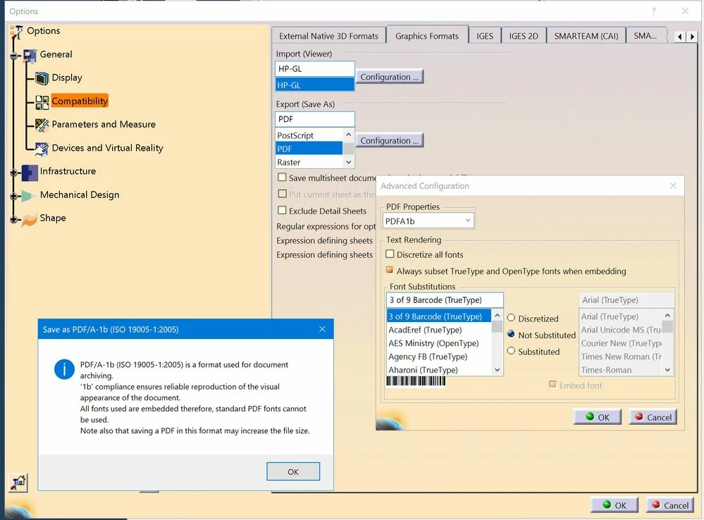

Sep 20, 2024 3:08 PM UTC
You could try changing the PDF configuration of CATIA installed on the worker, like in the screenshot below, although mine doesn't have an option for PDF/A-1, only PDFA1a or b
I don't see any options in the Theorem worker recipe but you should ask them because there's often options that can only be configured with the right keyword or properties added to the recipe file manually.

Hi @rhart,
I have tried the above option.
But it doesnt work on worker mode.
I have confirmed with theorem and ptc that there is no OOTB Config to achieve the above.
