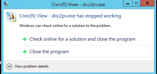

Hi All,
I've set up the office worker on a separate server using the Adobe Experience Manager. The Worker Daemon is started from a CMD Window and not set as a service.

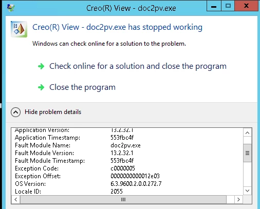

While publishing the doc2pv.exe application crashes.
Details: Windchill 10.2
            Creo View Adapters 3.0
            Adobe Experience Manager 6
The application crashes while publishing an Excel Doc (see attachment) . For Word the job fails directly with the following error:
17.08.2016 09:55:39:Failed to publish document file "D:/FTP/worker/w1i1j6/test.docx" to "D:/FTP/worker/w1i1j6/test_docx.pdf"
17.08.2016 09:55:39:Document Processing Returned: $ERROR$ Failed to publish document file "D:/FTP/worker/w1i1j6/test.docx" to "D:/FTP/worker/w1i1j6/test_docx.pdf"
17.08.2016 09:55:39:CadAgent Returned: $ERROR$ Failed to publish document file "D:/FTP/worker/w1i1j6/test.docx" to "D:/FTP/worker/w1i1j6/test_docx.pdf"

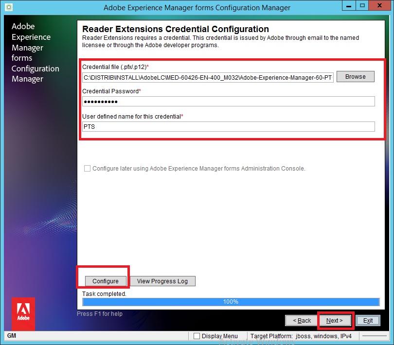

Aug 25, 2016 1:22 PM UTC
file=doc2pv-rcp
ver=5
lastp=conv
adapter/mergeProperties=0
adapter/serverVersion=1000
adapter/useAdobeLiveCycle=1
adapter/LCserver=localhost
adapter/LCport=8080
adapter/LClogInId=administrator
adapter/LCpasswd=password
adapter/enableCommenting=1
adapter/LCreaderExtnAlias=PTS
You must set the adapter/LCreaderExtnAlias property.

Aug 25, 2016 9:16 AM UTC
Copy the folders "i486_nt" and "recipe" to "doc_setup" folder.
Copy the file bin\doc2pv.exe to "doc_setup" folder.
Change paths in the files docworker.bat and docbatch.bat.
