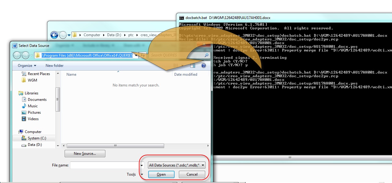

Hi Binesh, Thanks for the help. The link which you have provided helped me to rectified the issue.
But while publishing I got this window as shown in the below screen shot.
I am not sure which file it is looking for and why.Do you know which file is it looking for ? I clicked 'Cancel' and then it started to proceed and completed the job.
Rijoy Babu.
2-Explorer
Aug 14, 2015 8:50 PM UTC
Error  talks about property merge.
Could you see this helps Disabling the DTI properties option: EnableMerge in the recipe editor's Advanced> Miscellaneous section as Lori Sood‌ mentioned in Re: Office CAD Worker problem
