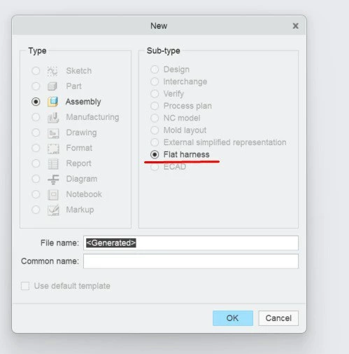

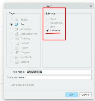

There are two sub-tupe models from Creo Cabling for harness and flat harness. But values of attribute Document Subcategory are empty in Windchill after checked in.

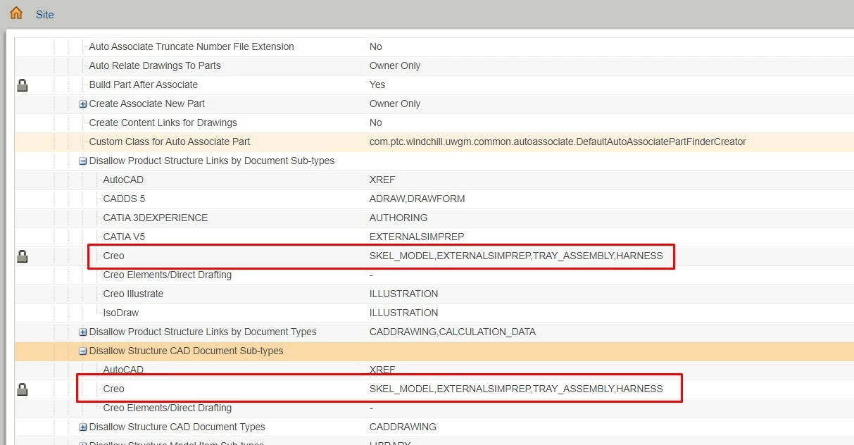

I want to use "Disallow Structure CAD Document Sub-types" in Preference Management via these values but I can't because they are empty.
Why values of Document Subcategory are empty in windchill for these models?
