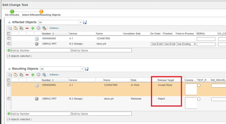

When I work in a project, its ussual that some assemblies (with parts, another sub-assemblies...) to clossed in a status that dont necessari promotions. I say this case: study.
It's possible to make a difference assemblies in Study and, more late, with a difference solutions i choose the accept solution?
Then, with this assemblies accepted, to pass like a promotion.
But I must to see the assemblies in Study state of the all assemblies that I send to prototype.
Is any possibility to make this situation?
Thank You.
HelesicPetr
May 23, 2023
Hi @jtorres
I can imagine that change notice and task can be used for this needs.
It is not promotion notice it is change notice
You can define own lifecycle with own transitions that is set on the change task and if the change ends, the objects are send to the state by the transaction.
Also you can customize the workflow and there can be some code and aditional logic that can work with object and manipulate with them.
Just example
This is just Idea. The realization would take a while.
