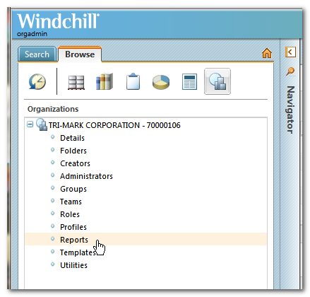

Chrystal,
When a Project Manager deletes a Project in ProjectLink, it is marked deleted and access is removed but all the data is still there.  As an admin you can go to the ORGANIZATION in the navigator and choose Reports. (See screenshot.)
In the Reports page there is a Projects table, change the view to deleted and you will see all the Projects that have been set to delete.   You can restore them to operation or you can remove the content.  (See screenshot)
I think if you "Restore", and maybe restart the project all should be back to normal.

'Restore' worked like a charm.  Thanks for the help!
