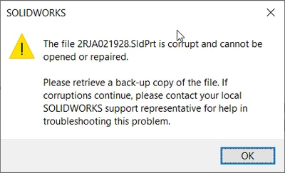

Don't we have a backup and restore system that allows us to restore files that have been corrupted
. Don't we have a backup and restore system that allows us to restore files that have been corrupted by Windchill (and not by the user)?

Can't tell if this is a Solidworks issue or Windchill issue. If the object has iterations, you can try opening an earlier iteration and see if its ok. It might be close enough for you to repair issues and move on (leap frog older iteration to latest). If you have a concern about data corruption of files in your vaults, I suggest you run wt.fv.tools.WContentVerify which can look for corrupt files. It will check for existence of the files, if their size and other attributes match the database records and if the CRC is correct. Are you seeing this on a bunch of files?

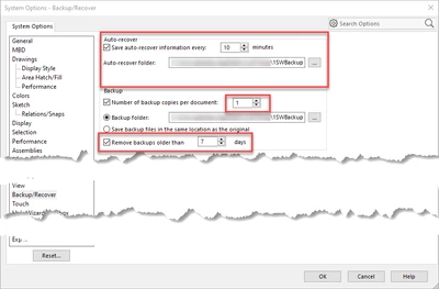

Was this file pulled directly from Windchill? If so, is there a previous iteration that could be pulled? If not, you are kind of at the behest of how Solidworks manages files (even if using the Workgroup Manager). Solidworks doesn't store "iterations" locally, even using WGM. It uses a local file location. There is, however, a Solidworks setting to save a backup of up to the last 10 copies of a file.  That is the best I have found.
