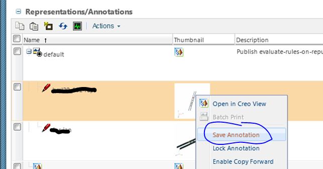

Exporting a work package is still a little more involved than he was looking for. What he wants in an auto-generated document that contains information about the part in question (number, name, revision, etc.) plus a still shot of the representation's default orientation. Basically eliminating the need for someone to download then paste the pic into a document.

Another option is to insert a hyperlink into the document that would then launch Creo View and the representation live from Windchill.    There is a query report that can be found on this site that finds "markups and annotations".  It's a nice report because it includes the hyperlink to the Representation in the output.  You could setup the report to find the links based on part numbers or even the markup name.  You could creatively name all the markups or annotations and then find them all in one report!  I've got mine customized to find based on date, who created it, File name or Represenation name.
If you RMB click in the Representation table in Windchill, there is an option to save the annotaion...this is where the hyperlink exists.  This would be the manual way to attain the link...so you can test it out.
MarcoTosin
Oct 30, 2015 12:55 PM UTC
This is the report you cited. EPMDOCUMENT_Markup and Annotation Report.qml
