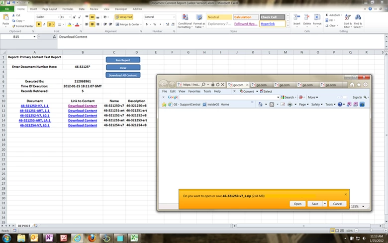

Jan 25, 2012 7:28 PM UTC
Hi Bernard,
We had a similar requirement but it was for documents. I wrote a query
in report manager and embedded that query into excel. This allows the
users to query Windchill and download the content without having to go
to the information page for each object.
I'm using VB to control the buttons (Run Report, Clear, Download All
Content). This should be easy to re-create for EPMDocument attachments.
Let me know if you're interested in this option and I'll send you some
more detail.

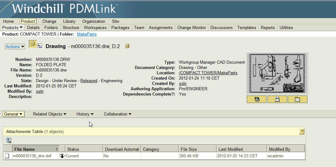

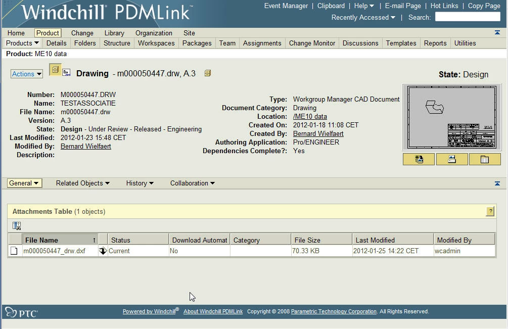

Jan 26, 2012 10:37 AM UTC
Hi Stephen,
The dxf file is a secondary contents attachment to the drawing, seeattached picture. We are using WTParts as well. The drawing and 3Dmodel are associated the the WTPart.
Best regards,
Bernard Wielfaert
Software Engineering
LVD Company NV
