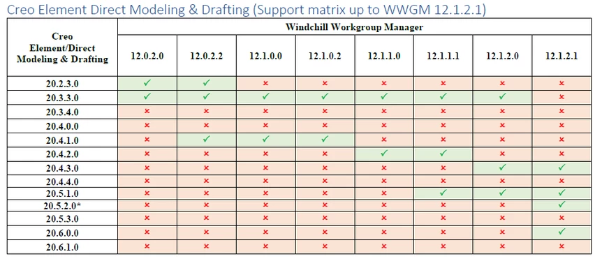

Is the version not compatible according to this chart?

Yes, it is, Drafting 20.4.0.2 with WWM 12.0.2.0... 🙄

Have you tried upgraded CoCreate on that system to 20.4.1.0 which is supported?
