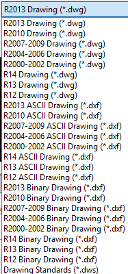

Did you convert the file to DWG or are they native?  I ask this because I assume DraftSight files have a different file extension?
TomU
Jun 8, 2017 12:40 PM UTC
No conversion required.  DraftSight's default file extension is DWG.
