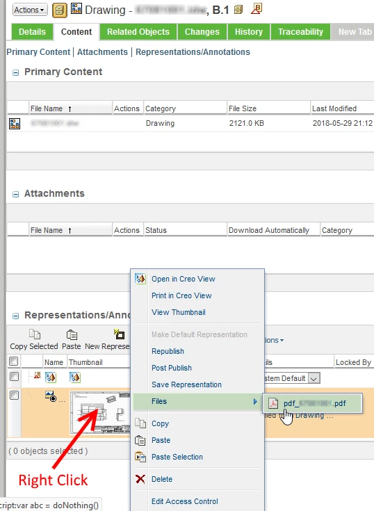

Hi All, I'm looking at an issue we have. Some users are collating copies of released drawings in PDF outside of Windchill because it's too much pain pulling a full drawing set from the products and Libraries. We have project Link but are restricted from using this externally.

@Roy_Crerar
Can you download the PDF from the drawing content Tab?  Go to the Content tab, then page down to the  Representations/Annotations section, right click over the thumbnail, a popup menu will appear.  Select Files.  If your CADworker has been set up to produce PDFs one will be there.
James

Hey
İf not, check publish rules settings. If you have problems, you can write to me.
