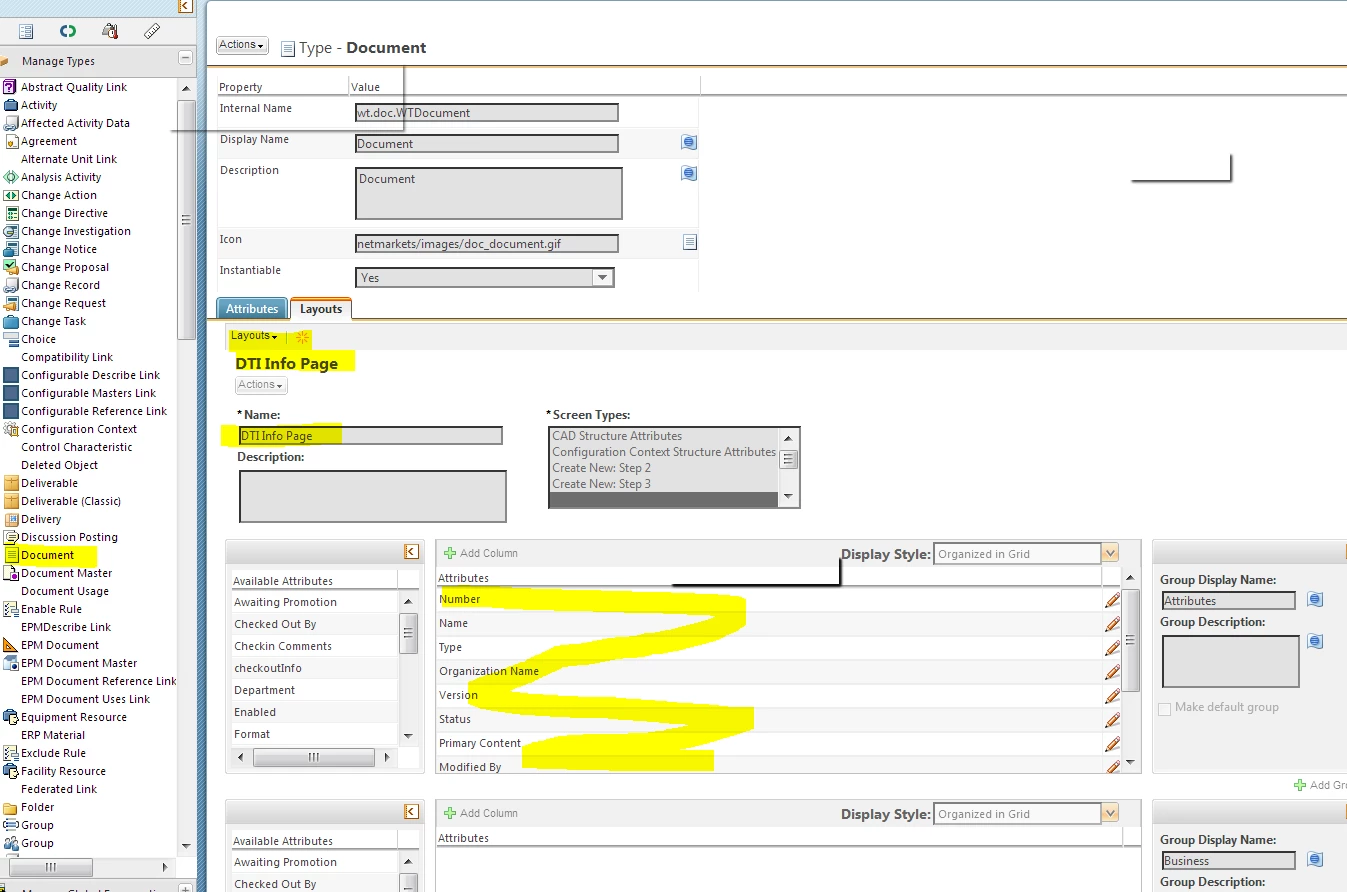

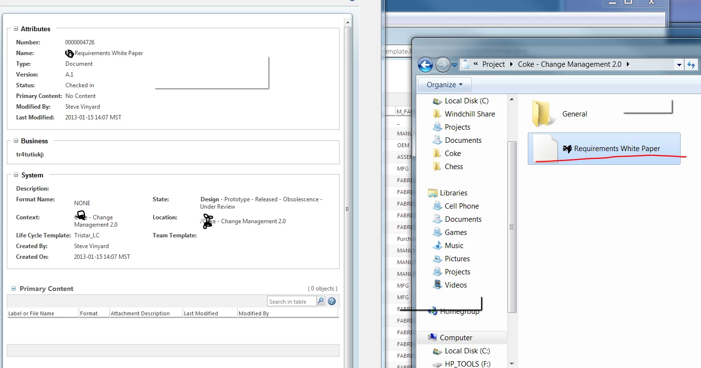

Hi Mike, see the two screenshots below. If you want to alter this its simply a matter of updating the layout. You can configure it to look like whatever you want in the type manager (see bottom screenshot).
OOTB Info Page layout:
[cid:image003.png@01CE102E.08B87750] [cid:image001.png@01CE102D.60FED810]
Layout Updates to DTI Info page:
[cid:image002.gif@01CE102D.60FED810]

You didn't mention what Windchill release you are using; info below is valid for Windchill 10.x.
The typical Windchill attributes such as the one you are interested inare available OOTB via DTI for insertion as a document property field in MS Office applications.
Simple how-to: https://www.ptc.com/appserver/cs/view/solution.jsp?n=CS45089
CS150532
From here you can test various actions, like "Info Page Test", "Refresh Attributes Test, etc.
