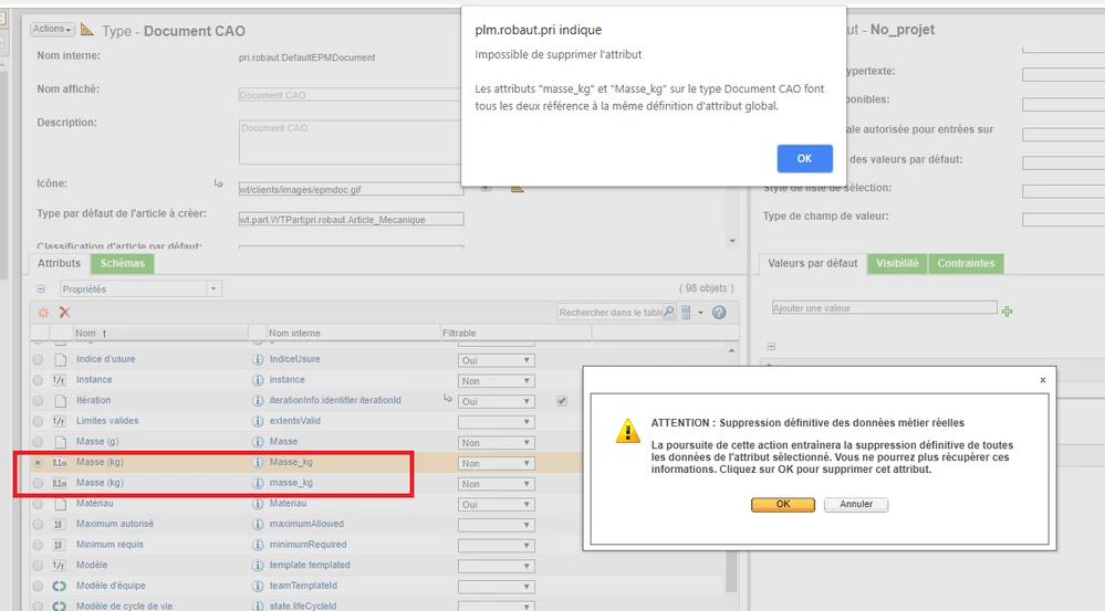

Hello.
I've got a question the support can't answer (despite of request escalation, no answer...), can somebody here help me ?
It seems that my connexion failed during saving a new attribute on EPDM doc type, it didn't appeared on the page so I created it a second time... But now I've got two attributes with the same name, and it generates an exception :
Support asked me to do some queries on the database, there is a duplicate entry in LWCIBAATTDEFINITION :
- In LWCIBAAttDefinition table :
IDA2A2 : 15391764
IDA3A5 : 49376
IDA3A7 : 15380685
CLASSNAMEKEYA7 : wt.iba.definition.UnitDefinition
IDA2A2 : 15392262
IDA3A5 : 49376
IDA3A7 : 15380685
- In LWCTypeDefinition table one entry wich IDA2A corresponds to the IDA3A5 from the other table :
IDA2A2 : 49376
Since then, no more answer from support. I tried to remove one of the entries from LWCIBAAttDefinition but it just made Windchill EPDM doc informations page crash so I went back...
Any idea ? I'm using SQL server.
