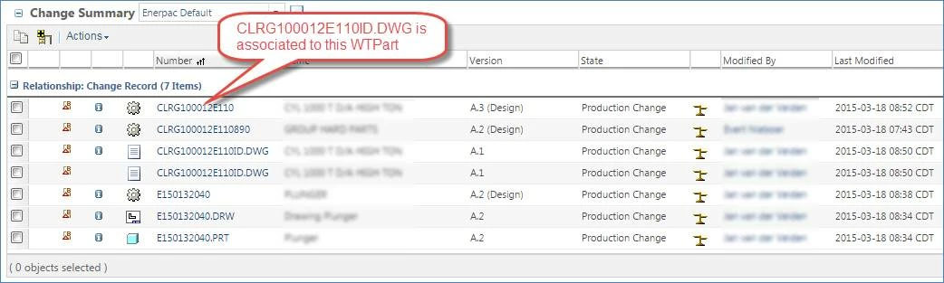

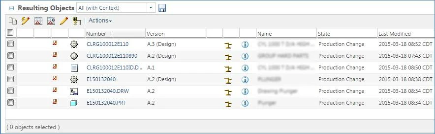

BenPerry
Mar 18, 2015 4:17 PM UTC
Example reproduced today:
[cid:image001.jpg@01D0616D.2C593E00]
[cid:image002.jpg@01D0616D.2C593E00]
