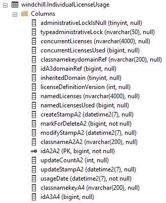

TomU
Jul 13, 2023 7:56 PM UTC
@joe_morton,
You can see license allocation in the IndividualLicenseUsage table in the database.  I would be very surprised if the same user was being assigned more than one concurrent license (of the same type) within a single 24-hour period.  Filter where namedLicenses IS NULL and usageDate is today (or whatever day you're interested in.)  Login events get triggered a lot, but these shouldn't impact the number of licenses granted to a single user.
joe_morton
Jul 13, 2023 8:31 PM UTC
hi Tom,
Thanks for the reply. We didn't see a namedLicenses column. We searched with namedLicensesUsed set to NULL, but there weren't any results for that.
I actually have the scenario today where I see (from my reporting) 1 user who logged in using a View ADU, but Windchill shows 3 licenses used. In the IndividualLicenseUsage table, we saw 1 record for that user today. Is there a way for me to see in the database who those 2 other users supposedly are?
TomU
Jul 13, 2023 9:27 PM UTC
I wonder if maybe the columns have changed between Windchill versions.  This is from 12.1.2.2:
As far as tying these records to users, just join this table to the WTUser table.  Then you can display the matching username, last name, or full name.
IndividualLicenseUsage.idA3A4 = WTUser.idA2A2
