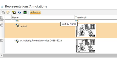

Hello all,
in my Windchill-12, in Representation/Annotation table, initially it was showing 1 representation but as soon as I updated and promoted the drawing to released, it is now showing 2 same representation. how?
is it okay if I delete the other representation ? see snap attached
Br,
Sandeep C.

Hi @SC_8321054
Yes it is.
set the property to false.
PetrH

Hello @SC_8321054
It is standard behavior that the representation is generated during promotion process.
The promotion representation can be used for notes and so on.
Article CS340395 describes how to turn on/off the promotion representations
Hope this can help
PetrH
Jun 19, 2023 7:36 AM UTC
How to OFF this promotion representation? it is not mentioned in Article CS340395.
Br,
Sandeep C.
HelesicPetr
Jun 19, 2023 7:55 AM UTC
Hi @SC_8321054
Yes it is.
PetrH
