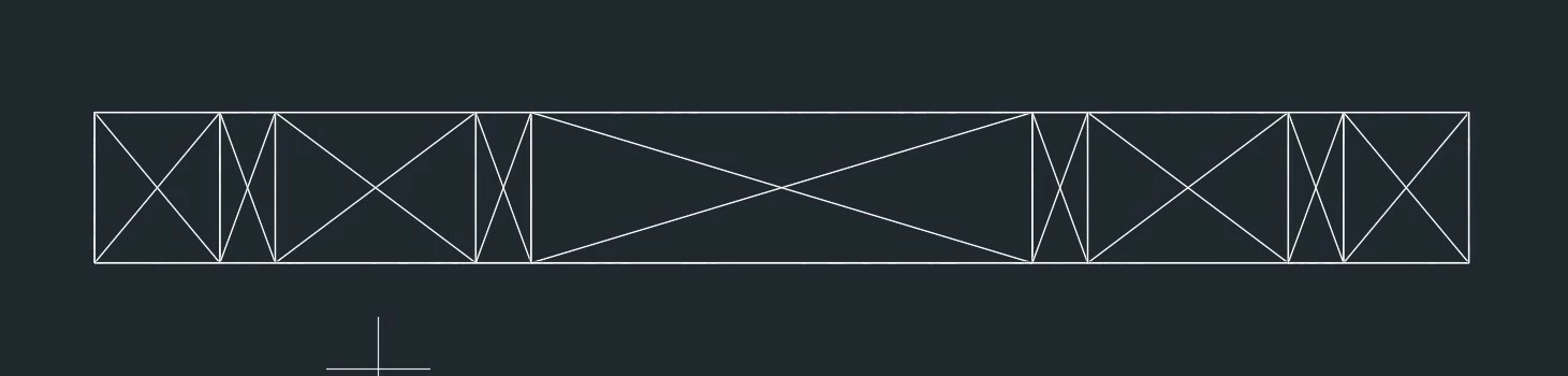

Andy,
Our Config has that called out. Attached is an example of a simple laser cut strip and a snap of the config details.
