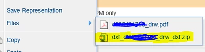

I am using Windchill PDMLink Release 11.1 and Datecode with CPS M020
intf2d_out_generate_log_file has no effect while exporting DRW to DXF, it creates log file and in representation dxf is zipped.
I need to have single dxf file in additional file list instead of dxf_XXXX.zip

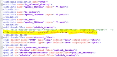

    Yes issue is generic with all drawings where it creates dxf file and its output log file which gets zip and shown in Additional Files as shown below
    Yes I am using custom publishing rule as below

    Sep 24, 2025 1:42 PM UTC
    You did not specify which version of Creo View Adapters you are using but it could be this issue fixed in Creo View Adapters 8.1:
    https://www.ptc.com/en/support/article/CS349211
    Sep 25, 2025 6:17 AM UTC
    Thanks Mr Jones, I was using Creo Adapter 7.1 and after installing 8.1 issue is resolved. Thanks a lot and have a great day.
