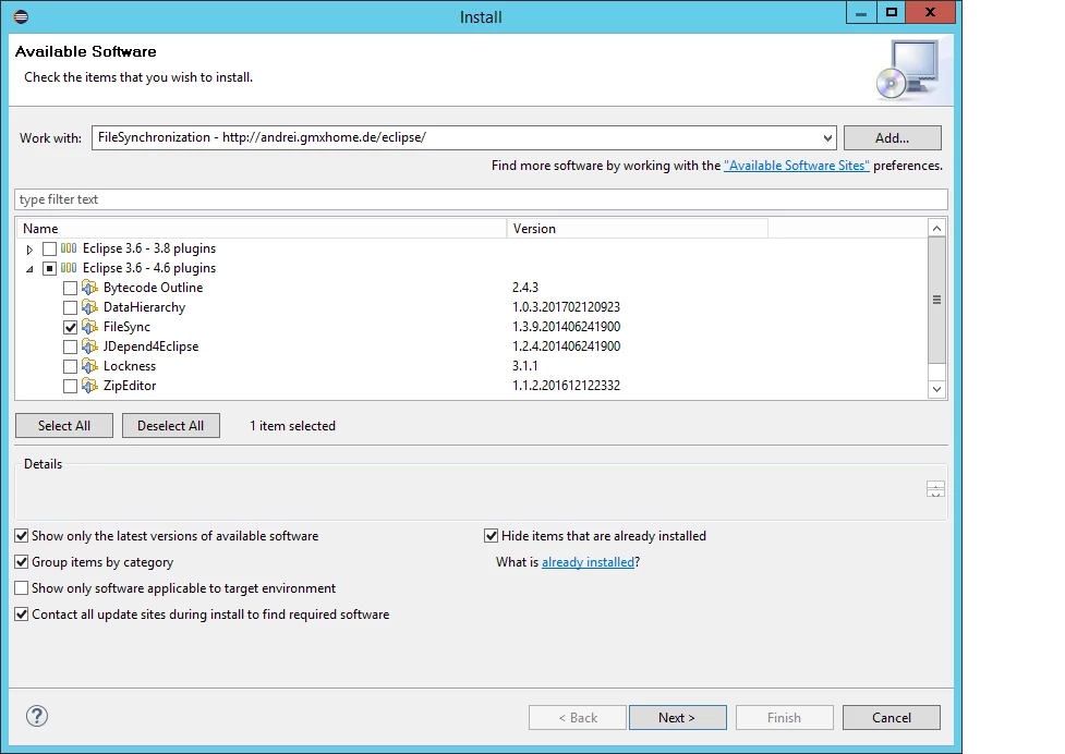

Apr 26, 2017 6:35 AM UTC
Hi Syed,
I used your document. Still I am not getting the File Synchronization in eclipse. I am sharing that screens, please help me.
