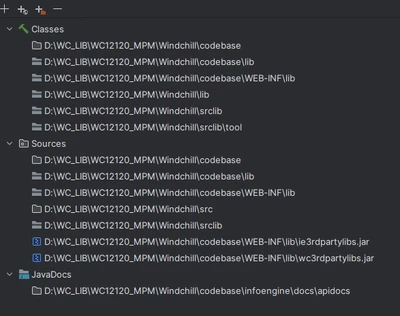

HelesicPetr
Oct 14, 2025 12:57 PM UTC
You have to configure your IDE to use je libraries in the project,
Something like this >
PS> you have not mentioned any error you could see.
PetrH

HelesicPetr
PetrH
