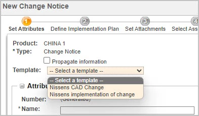

Hello everyone,
Can you please help me?
I´d like to know, if there is possibility to create new template for ECR that will allow me to choose between two or more options, when creating an ECR.
I would like to use it for a bit different process (almost identical process wise) but with different participants.
I know, there is a possibility to create new templates for ECN (tried that and worked well), however I would need separate the two processes on ECR level.
Thank you in advance for your feedback 🙂

I would recommend to use new ECR subtype. (Create new ECR subtype and set it as you need)
You can set different OIR and team template or different workflow process.

No, there is no templates (at least in 12) for Change Requests, only change notices.

That is exactly what I was aiming for. Thank you very much for pointing me in right direction!
