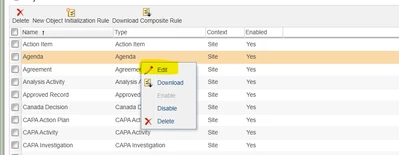

Hi @cspinelli
What do you mean XML associated to OIR?
OIR is the XML file that describes the rules.
You can download it and modify the file in a text editor and then upload it by OIR edit function.
So you don't have to delete the rule and add new one.
You can just edit it.

cspinelli14-AlexandriteAuthor
Dec 20, 2023 12:54 PM UTC
ok thanks so maybe i've not the Edit function in Windchill 10,2

Dec 20, 2023 1:01 PM UTC
Make sure you have permission , use wcadmin user, to be on safe side
