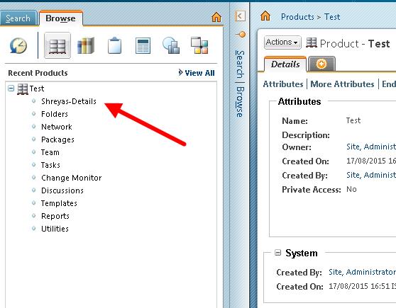

Hello all,
I want to edit product subtitles (Details,Folders,Workspaces,Packages,Team,Tasks..)
For example, I want to change "Details" as "Detaylar".  How can I edit ?
Thanks in advance.

Aug 17, 2015 9:30 AM UTC
  Labels for this actions are rendereeyasd from \Windchill\src\com\ptc\core\ui\navigationRB.java  class
You can update the Java class to change the display.
I am not  sure about language which you are using.  You can also check the  if your language is available in Language Pack.
Hope it helps !!!
Shreyas
cdurmaz1-VisitorAuthor
Aug 17, 2015 10:49 AM UTC
Dear Shreyas,
I updated that folder then I restarted the Windchill but there is no any change.
Aug 17, 2015 11:26 AM UTC
After updating those files you need to compile java class and restart windchill services. You can run below command to compile java class.
ant -f bin/tools.xml class -Dclass.includes=com\ptc\core\ui\navigationRB.java
