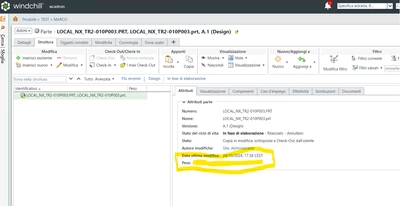

Editable field in WTpart structure attributes
Version: Windchill 13.0
Use Case: List of soft type editable
Description:
Hello, some one knows how to create 1 or more attributes editable to insert in structure wtpart or similar.
For example i would like to insert "weight"
in this page

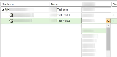

You can do inline editing when in a structure view. See: https://support.ptc.com/help/wnc/r11.2.1.0/en/index.html#page/Windchill_Help_Center/NewandChanged_11_2_10_PSBInlineEditing.html
Make sure that the preference is enabled: https://www.ptc.com/en/support/article/CS375084?source=search
Example:
