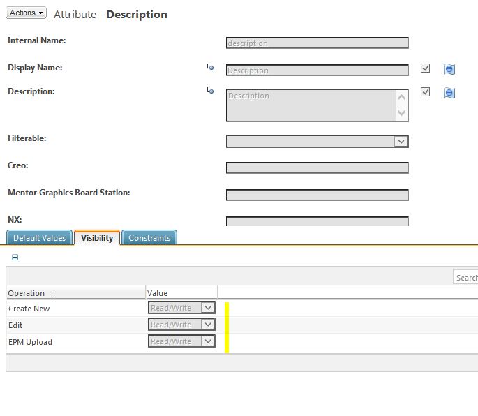

Hi there,
I tried to edit attributes of a CAD - Object in Windchill Essentials 10.2.
But somehow the field is not editable.
In attributes manager it says that its visiblity is set to read/write.
Any ideas?

type and attribute manager says, that rules are OK.
Role based access rules should not be a problem, because editing the CAD - file or other attributes is not a problem.

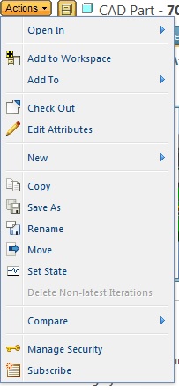

That looks like the Edit Attributes screen of the working copy of the object.  Get to the commonspace copy of the object (or check it in) and then edit Description.
Mat16-PearlAuthor
Mar 2, 2016 1:49 PM UTC
In commonspace all I can choose is "edit attributes" again (with the same result).
Shoud there been an additional menue item?
Mar 2, 2016 10:46 PM UTC
Ahhhh...that's a Creo file isn't it? We've seen that the Creo to Windchill links force a number of the attributes of CAD parts and the like to be fed only by Creo. So no you probably won't be able to edit that file because it is set within Creo and pushed to Windchill. You'll have to go through Creo to do what you want I think.
