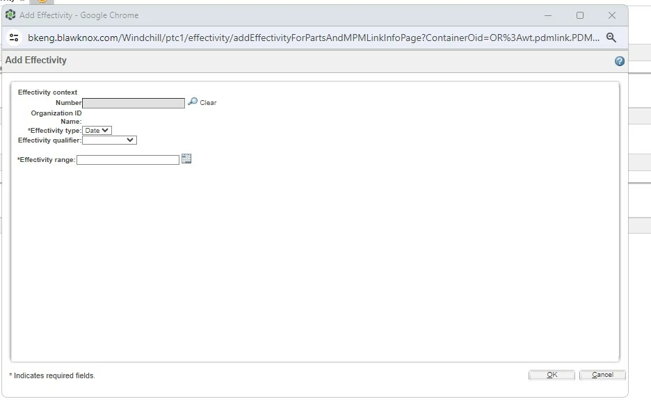

I would like understand how to record a serial number vs a date in effectivity.
So how do you add an Effectivity Type other than a Date and the qualifier can be specific serial number.
We are using Windchill 12.1

Technically you can go to the Type and Attribute management and add a new effectivity type (from a UI perspective), however you need to do customization to make your new effectivity type to work in a Config filter (as mentioned by @HelesicPetr ).

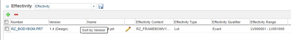

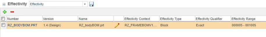

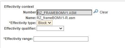

You just need to set the WTPart to Serial number traceable.
Then you can set the effectivity type to Lot or Block
Do not forget to assign a context assembly that is traced
