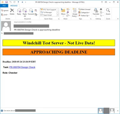

I modified all the notification templates on the test system to clearly communicate the emails are not from production.  Anytime I refresh the server (rehost) I just re-copy the modifed templates back into the codebase  (using wtSafeArea.)
Here is the HTML block added to each template:

<table id="test_server">
 <tr>
 <td>Windchill Test Server - Not Live Data!</td>
 </tr>
</table>
<br>
