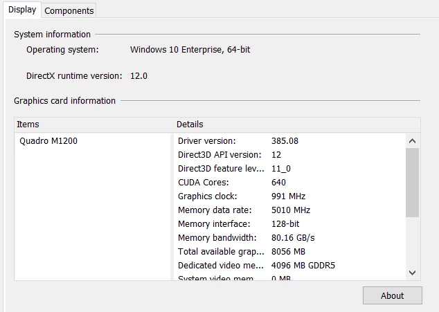

Embedded browser in Creo 4.0 M010 has no scroll bars. Neither scaling nor detaching the browser helps. Can't access lower right part of web page. Using WC 11.0 M020 on Windows 10.
Cannot do any number of WC tasks as I cannot access the lower right part of the Creo embedded web browser.

What is the resolution of your screen?

Hi!
I have try with IE11 & Chrome, and it didn't work...
But this issue is not on every type of computers, it is only on my Laptop.
It works okay on a tower, so it could be something about the graphic card, i belive!

it was solved? I can't see the case opened... I got a user with the same problem recently. He uses notebook w/closed screen, and a monitor. Aparently when he changes from one to another, Creo messes up the browser visualization hiding the scroll bars. It's only solved when I change the resolution scale to 100% (it was 120%) and mandatorily restart the computer.

See this post for issues when Windows 10 display scale is larger than 100%:
https://community.ptc.com/t5/Additional-Creo-Questions/Creo-Parametric-4-0-embedded-chromium-browser-display-issue-with/m-p/493194
