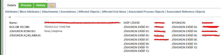

hello, if I remember correctly, when I put an attribute in the more attribute layout, it was not showing on the screen if no data was entered into it.
However, at the moment, the attributes that I added to more attributes and did not enter data into appear on the screen, creating a bad image.
How do I prevent the attributes that I do not enter data into appear on the screen?

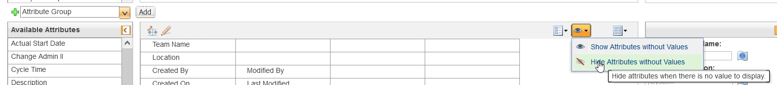

Dec 15, 2022 2:54 PM UTC
In the layout, go to the layout you want to edit, click on the 'eye' icon and choose the option to hide attributes without values. See screen shot.
Dec 16, 2022 8:01 AM UTC
Wonderful. thank you very much. That's why I love community so much.
