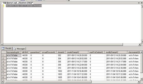

On your machine via SQL Query or SQL Server Management Studio, if we query 'fvItem':
"select top 10 * from fvItem;"
Does this show any records?
Kalyani Homkar
Oct 5, 2016 1:42 PM UTC
Yes, It's showing the Records.
