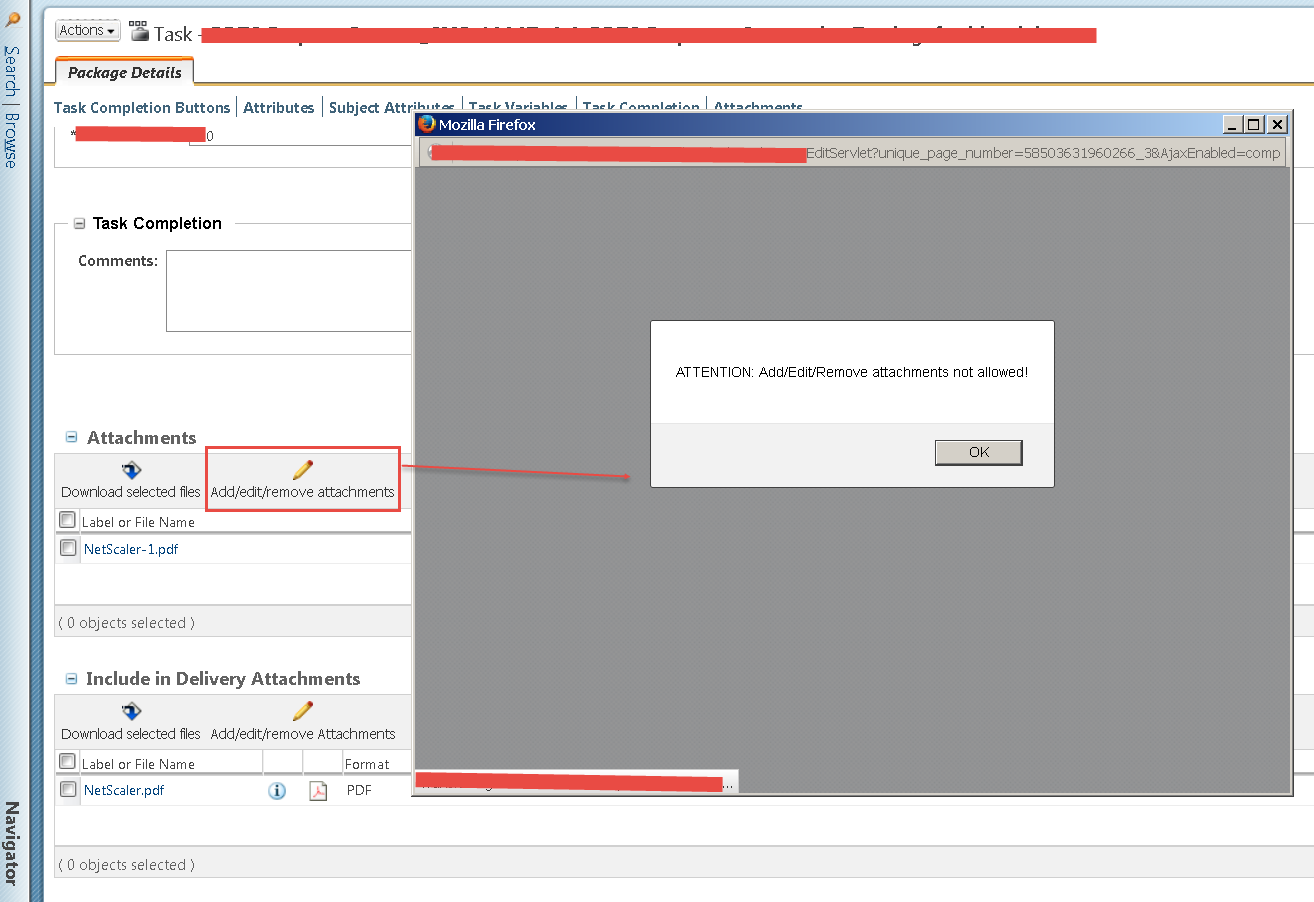

I am getting an error while editing attachments from a workflow task using a task form template. The PBO used is a subtype of work package. The same user can edit the package if he tries the same action from package > attachments tabs.
Error in MS log
2016-03-02 09:46:37,747 ERROR [ajp-bio-8010-exec-1] com.ptc.core.components.factory.dataUtilities.NmHTMLActionModelDataUtility binesh.kumar - Could not find action model named:
(com.ptc.netmarkets.util.misc.miscResource/400) com.ptc.netmarkets.model.NmException: actionmodels.xml file is missing an entry called .  Please add the model and restart the server.
The action model info for the action is
What we did was all configurations, no customization.  Did any face this issue before with task form template?
Thank you

Best answer by BineshKumar1
Got the SPR fix in CPS 16
https://support.ptc.com/appserver/cs/view/spr.jsp?n=5281937

Binesh Kumar‌,
Yes - I've absolutely ran into this and logged a ticket.  They told me it was benign and to ignore it.  I tried to argue for at least a fix in CPS so that the Windchill logs would not get clogged with this "benign" message that is approximately 120 lines long, if I remember right.
CS210910‌.  The article says it is planned for 10.2 M030 CPS07.  But I dont think it ever made it.  I am on CPS10 or something and I'm still getting the errors in the MS logs.
Boy, you sure got me lit up on a Friday about this PTC software.  This one makes me so angry that they just can't fix it.  Every time a user clicks onto a workflow task, the message is populated into the MS logs.  On a related note, I think if you navigate to the Container > Tasks page for the container that this workflow task is located, you'll get some additional "benign" messages populated into the logs.
