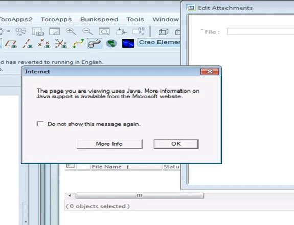

Error Message for Java While Using ie_in_process [summary]

Thanks to all that replied and especially to Ron Thellen for pointing out that when running the ie_in_process option on a 64bit install, the version of IE used is x64 instead of the x32 and that I would need the x64 version of java installed for the applet to run correctly.
