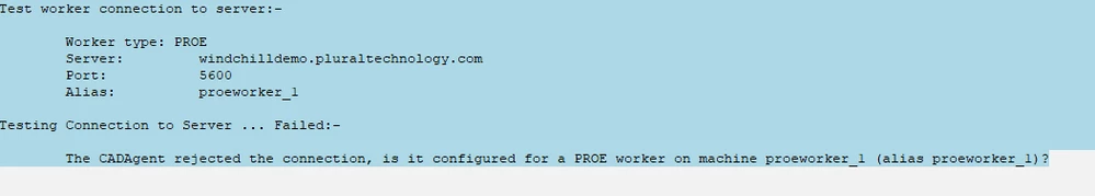

I have been trying to configure CAD worker for Creo Parametric to work with Windchill PDMLink 12.0, but getting the error with connection to the Windchill Master Server. I have also tried all the steps from PTC Articles related to this error yet couldn't find a resolution. Connection Error MessageConnection Error Message
 What could be causing the CAD worker's configuration issues when using the Creo View Adapter to work with Windchill?
Would appreciate anyone's support or guidance in resolving this configuration issue.

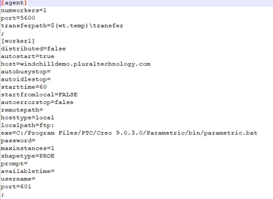

Agent.ini file below fyr
LocaHost Alias entry
"127.0.0.1 --windchilldemo.pluraltechnology.com --proeworker_1"

Take a look at this article:
Failed to test connection to server with message “The CADAgent rejected the connection, is it configured for a XXX worker on machine XX (allias not set)?" during setting up a worker with Creo View Adapter
https://www.ptc.com/en/support/article/CS42750

Thanks for sharing, however I have tried all resolution points yet no luck with getting the connection.

Rohaan,
As per the error the server is not able to find the appropriate entry for this worker
Would be able to share the agent.ini entry for this worker?
Have you added the host entry in the server to map the alias name?
Does ping/telnet from worker (601) <--> Server(5600)
