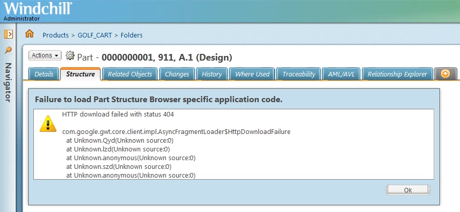

Whenever I want to access a WTPart's structure page I am getting an error.
In method server it's showing
com.google.gwt.user.client.rpc.IncompatibleRemoteServiceException: Type 'com.ptc.cat.prefs.client.PreferenceParams' was not assignable to 'com.google.gwt.user.client.rpc.IsSerializable' and did not have a custom field serializer. For security purposes, this type will not be deserialized.
at com.google.gwt.user.server.rpc.RPC.decodeRequest(RPC.java:308)
at com.ptc.mvc.gwt.GwtHandlerAdapter.processCall(GwtHandlerAdapter.java:155)
at com.google.gwt.user.server.rpc.RemoteServiceServlet.processPost(RemoteServiceServlet.java:224)
at com.google.gwt.user.server.rpc.AbstractRemoteServiceServlet.doPost(AbstractRemoteServiceServlet.java:62)
at com.ptc.mvc.gwt.GwtHandlerAdapter.handle(GwtHandlerAdapter.java:117)
at org.springframework.web.servlet.DispatcherServlet.doDispatch(DispatcherServlet.java:790)
at org.springframework.web.servlet.DispatcherServlet.doService(DispatcherServlet.java:719)
at org.springframework.web.servlet.FrameworkServlet.processRequest(FrameworkServlet.java:669)
at org.springframework.web.servlet.FrameworkServlet.doPost(FrameworkServlet.java:585)
at javax.servlet.http.HttpServlet.service(HttpServlet.java:641)
at javax.servlet.http.HttpServlet.service(HttpServlet.java:722)
at org.apache.catalina.core.ApplicationFilterChain.internalDoFilter(ApplicationFilterChain.java:305)
at org.apache.catalina.core.ApplicationFilterChain.doFilter(ApplicationFilterChain.java:210)
at wt.httpgw.filter.WTContextBeanFilter.doWithWtContextBeanHandler(WTContextBeanFilter.java:98)
at wt.httpgw.filter.WTContextBeanFilter.doFilter(WTContextBeanFilter.java:58)
at org.apache.catalina.core.ApplicationFilterChain.internalDoFilter(ApplicationFilterChain.java:243)
at wt.servlet.CompressionFilter.doFilter(CompressionFilter.java:237)
at wt.servlet.RequestInterrupter.doFilter(RequestInterrupter.java:327)
at wt.servlet.ServletRequestMonitor.doFilter(ServletRequestMonitor.java:1594)
at wt.servlet.ServletRequestMonitorFilter.doFilter(ServletRequestMonitorFilter.java:56)
at org.apache.catalina.core.StandardWrapperValve.invoke(StandardWrapperValve.java:222)
at org.apache.catalina.core.StandardContextValve.invoke(StandardContextValve.java:123)
at org.apache.catalina.core.StandardHostValve.invoke(StandardHostValve.java:171)
at org.apache.catalina.valves.ErrorReportValve.invoke(ErrorReportValve.java:99)
at org.apache.catalina.core.StandardEngineValve.invoke(StandardEngineValve.java:118)
at org.apache.catalina.connector.CoyoteAdapter.service(CoyoteAdapter.java:407)
at org.apache.coyote.ajp.AjpProcessor.process(AjpProcessor.java:200)
at org.apache.coyote.AbstractProtocol$AbstractConnectionHandler.process(AbstractProtocol.java:589)
at org.apache.tomcat.util.net.JIoEndpoint$SocketProcessor.run(JIoEndpoint.java:310)
at java.util.concurrent.ThreadPoolExecutor$Worker.runTask(ThreadPoolExecutor.java:895)
at java.util.concurrent.ThreadPoolExecutor$Worker.run(ThreadPoolExecutor.java:918)
at java.lang.Thread.run(Thread.java:662)
at org.apache.tomcat.util.threads.TaskThread.run(TaskThread.java:77)
Caused by: com.google.gwt.user.client.rpc.SerializationException: Type 'com.ptc.cat.prefs.client.PreferenceParams' was not assignable to 'com.google.gwt.user.client.rpc.IsSerializable' and did not have a custom field serializer. For security purposes, this type will not be deserialized.
at com.google.gwt.user.server.rpc.impl.LegacySerializationPolicy.validateDeserialize(LegacySerializationPolicy.java:127)
at com.google.gwt.user.server.rpc.impl.ServerSerializationStreamReader.deserialize(ServerSerializationStreamReader.java:538)
at com.google.gwt.user.client.rpc.impl.AbstractSerializationStreamReader.readObject(AbstractSerializationStreamReader.java:71)
at com.google.gwt.user.server.rpc.impl.ServerSerializationStreamReader$ValueReader$8.readValue(ServerSerializationStreamReader.java:137)
at com.google.gwt.user.server.rpc.impl.ServerSerializationStreamReader.deserializeValue(ServerSerializationStreamReader.java:384)
at com.google.gwt.user.server.rpc.RPC.decodeRequest(RPC.java:296)
... 39 more
attached screenshot of the error
