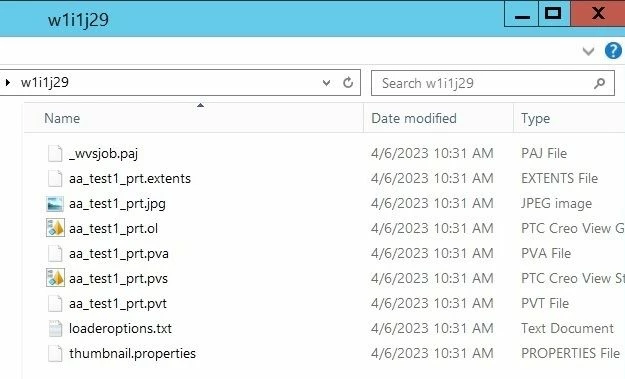

The windchill system (application, sql and publisher) had to be restored last week from a Veeam backup by Corporate IT.  Since the restore I have not made changes to the system.  As a test I tried creating a simple drawing on a current format.  During checkin here is what I see in the worker temp file:
To further complicate matters, in rare cases the pdf file will publish, but I so far I don't see any pattern for these rare occurrences.
