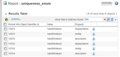

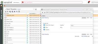

Windchill complains about below entry in DB
LWCLocalizablePropertyValue:5422
you can import the attached qml on the target system and run it with the given id 5422, it should then give better sight in the problematic entry in DB

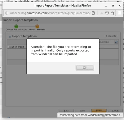

Thankyou for your response. I tried importing your attached qml on the target system but I am facing the below error:
Is there something wrong that I am doing?
Fadel
23-Emerald II
Nov 22, 2023 7:21 AM UTC
import as QMl not as template
