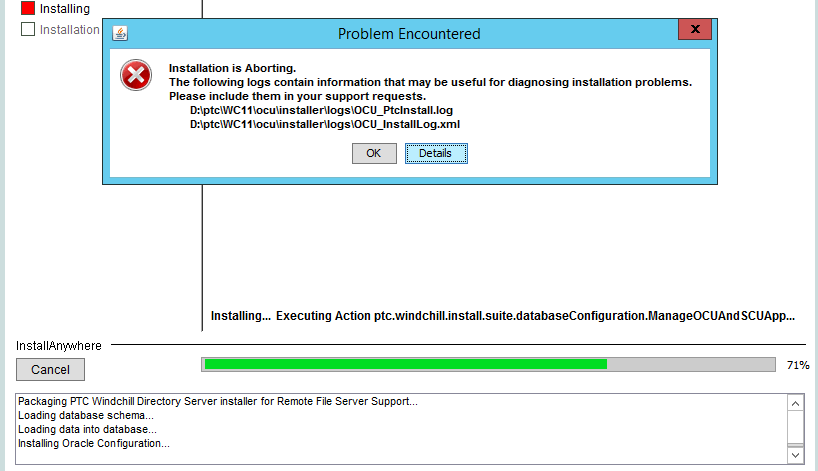

We're using Windchill 10.2. As a part of upgrading to 11.0, we're testing it in a test environment. 3 servers are configured as following in the same order as listed below;
  1. Oracle 11.2.0.4 and Windchill Directory Server are installed and configured in server WCDbSrv.company.com
  2. Business Reporting is installed in server WCBusRptSrv.company.com
  3. Windchill 11.0 M030 solution is to be installed in WCAppSrv.company.com. This task generates error as in below screenshot.
    Windchill Installation Error
I'm also attaching the log files mentioned in the error. Please help identifying the cause of error.
Thank you

Further analysis shows the error being thrown immediately after the following setup started running.
..\MED-60419-CD-110_M030\OCU\Disk1\InstData\Windows\NoVM\setup.exe
Any idea why it would throw error?
Thanks.
gafoorgk12-AmethystAuthor
Apr 7, 2018 6:15 PM UTC
Checked further. I think it has got something to do with Java. See below log lines from one of the PSI log files.

gafoorgk12-AmethystAuthorAnswer
Apr 14, 2018 4:03 PM UTC
I found the resolution for the issue. It seems PSI doesn't go very well with Windows Servers Auto Admin Approval mode.
Even after turning off UAC, installation was generating this error. But together with turning off UAC, if policy setting "User Account Control: Run all administrators in Admin Approval Mode" is disabled, PSI works fine.
