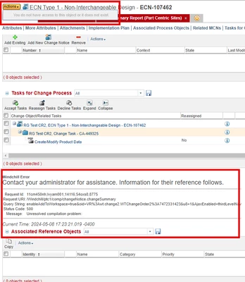

Error you do not have access to this object

Sounds like a compilation problem. What parts were customized?
https://www.ptc.com/en/support/article/CS382596?source=search
Found this similar article.

The reasons causing the error could be several.
In your case one is described in this article.
"You do not have access to this object or it does not exist" occurs when the user click the task link in the email notification for the workflow task
The object you do not have access to may also have been deleted.

Yes @avillanueva it was a compilation issue as you mentioned. I figured it out and fixed it. Thank you.
