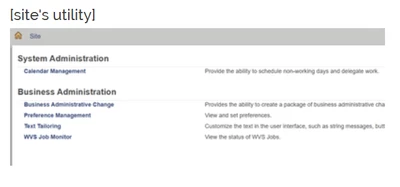

Errors occurring due to full license usage
Currently, some of my clients are experiencing issues with Windchill, such as the global search bar not appearing or contexts and libraries not appearing when accessing Windchill after granting all licenses.
Even after clearing the cache and reconnecting, the issue sometimes persists, and sometimes it reappears.
If the issue persists after clearing the cache and reconnecting, clearing one license will restore normal functionality.
Is anyone else experiencing this issue?

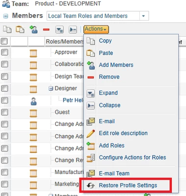

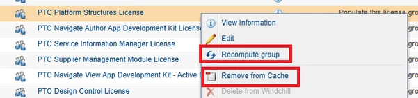

HelesicPetr
Aug 12, 2025 5:04 AM UTC
Hi @HK_10285495
Usually if you assign the profile it is really good practice to remove user from a cache and also recompute all groups that profile access and acl access are refreshed by the latest configuration.
It is common behavior that sometimes it is necessary to do so.
sometimes you have to restore Profile settings on a context from a team management
Be sure that the license does not have a profile that is disabled or any group

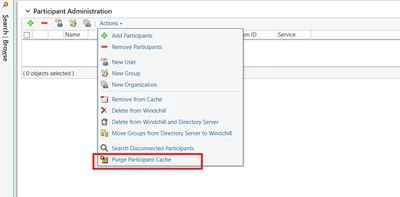

Fadel
23-Emerald II
Aug 8, 2025 9:08 AM UTC
Can you share more info on, the statement "clearing one license will restore normal functionality." ?
When this happens does purge participant cache helps ?
Buiꓘa
8-Gravel
Aug 10, 2025 10:37 PM UTC
well.... when this situation happened, i can't see the participant management. so i can't do this.
well.. 'clearing one license will restore normal functionality.' that means literally If i leave one license(Windchill advanced or base), there is no problem.

8-Gravel
Aug 10, 2025 10:41 PM UTC
yes, i allocated all licenses 100%.
Cache Means Local Cache.
i can't remove participant's caches because when this happened, my windchill can't show the menu like participant management, license management.

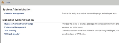

HelesicPetr
Aug 11, 2025 7:23 AM UTC
Hi @HK_10285495
This is well know issue with old licenses and some PTC license profiles combination
For example you assign a license that is not used anymore and a profile is disabled. That can case your issue
check following article
CS329469 - Missing links in "Site" > "Utilities" for "Administrators" after importing license files or upgrading Windchill
or
CS322772 - Administrator cannot access ‘License Management’ page after upgrading in Windchill PDMLink
or
CS324730 - Links missing in Site Utilities for Administrator users to Windchill PDMLink
PetrH
